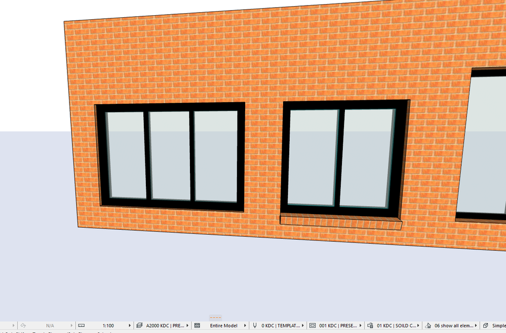

Hi everyone,
As I have been working on making my own template I have noticed that the opening lines of my window are not showing on the floor plan or the 3D window. I have tried different model views but nothing and different scales but they are not showing. I have also attached photos of a default Aus template where it shows the opening lines on floor plans and 3D windows. Can someone please explain what I might be doing wrong? Thank you.

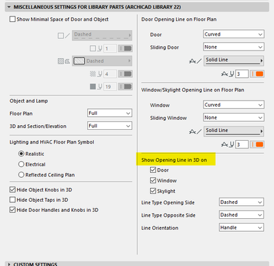

This has got to do with your MVO settings.
https://help.Graphisoft.com/AC/26/INT/_AC26_Help/050_ViewsVB/050_ViewsVB-109.htm
Ling.

ahh knew it had something to do with that. Thank you
