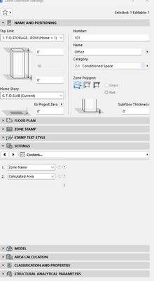

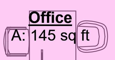

Could I delete the letter A? I want to show Only the area Calculated 9Number and Unit) under the room name.
Solved! Go to Solution.
2023-09-08 04:56 AM
Look around in the settings and you should find something about a prefix or heading.
I don't have anything open at the moment so can't show you exactly.
2023-09-12 12:04 PM
An alternative is to hide the Zone Stamp by unchecking the "Show Zone Stamps" checkbox in the Model View Options Dialog, then place a Zone Label, which can contain the exact text in the exact format you want.
2023-09-08 04:56 AM
2023-09-12 12:04 PM
