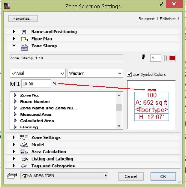

I can change the zone stamp font of the zone name. How can I do the same for the other zone parameters? This question was raised and answered with Archicad 14 but user interface is no longer looks the same. Thanks.

Go to Options > Element Attributes > Zone Categories and change your Zone_Stamp_1 18 to Zone_Stamp_2 18 in the required categories.
This will give you a far more versatile stamp that can change with scale and allows a greater range of font adjustment.
