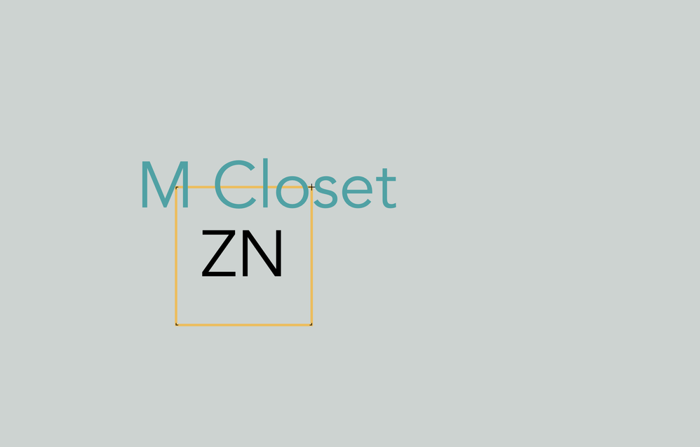

Hello everyone:
I was wandering if anyone has the same issue and found a way to solve it. When placing a Zone Stamp, I am asked to tun also on the labels layer. After placing the zone stamp, it also place an "Auto Text Label" with the ID of the zone. I need to delete it manually.
Does anyone know where to turn off this option?
Thank you ahead of time for your tip and help.
1 Reply 1
I am assuming you are using the latest update of 25?
If so, the zone tool has a new option to label the zone.
That must be on as default.
Simply turn it off before you place the next zone.
