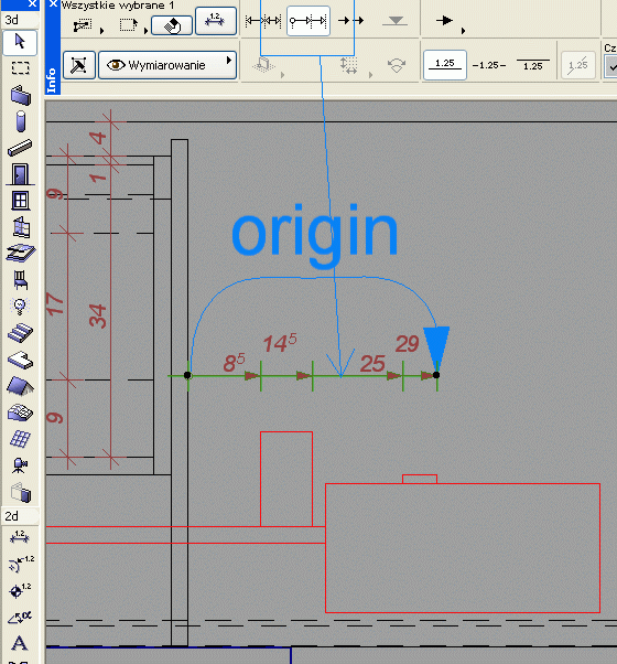

is it possible to reverse the origin of the dimensioning line when using "continuous method" ?

My point is whether is it possible to modify existing one as shown on the attached picture?
Sure, just select the dimension and mirror it.
Barry wrote:
Didn't work for me - AC14
Top dimension string in image below was mirrored.....is there a trick?
Not that I am aware of.
I just selected the dimension and used the pet palette to mirror it.
I agree with s2art. Is it AC14 bug?
Besides in 3D document there's no even possibility to mirror the dimension string.
Could well be.
At work I am on the latest build - 3862.
I just tried at home - build 3636 - and it didn't work.
And you a right there is no mirroring in 3D documents.
Yes latest hotfix solves the problem.
Still can't mirror in 3D docs though.
You are right Barry Kelly - latest 3862 hotfix fixed the bug. Besides I realised that my ArchiCAD was not up-to-date
Thanks everyone
