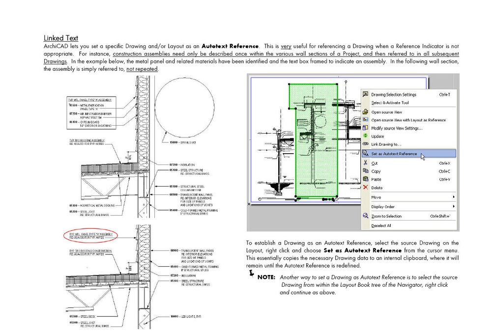

As far as a linked detail marker in another detail page, is there a way to use an autotext reference to refer to another detail? Or maybe an object or something? I just want a piece of text that will update if the detail that it refers to changes. It doesn't have to open up the detail... so far all I can do with the autotext is refer to the detail drawing it is already in, not the one I want to refer to. Any ideas? We can't upgrade...
Laura Yanoviak
From our BIM Manual...

Laura Yanoviak
...and the second page.

fantastic! that's exactly what i wanted! i had no idea about autotext references - now i can reference details in other details and not worry about updating the IDs - thanks again
