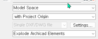

dimension after dwg export When the dimension line is moved, 0 will appear.
LeeJaeYoung
When the dimension line is moved, 0 appears.

Looks like a bug. AC has had a dimension creation rewrite recently which now retains nodes for hidden element hotspots. It is complicated. When exported to DWG duplicate points should be removed, it seems to have been missed. You should report it to your supplier or local support.

If it's something else, you'll get weird results.

AC25 6000 has just been released. You could see if that fixes it.
