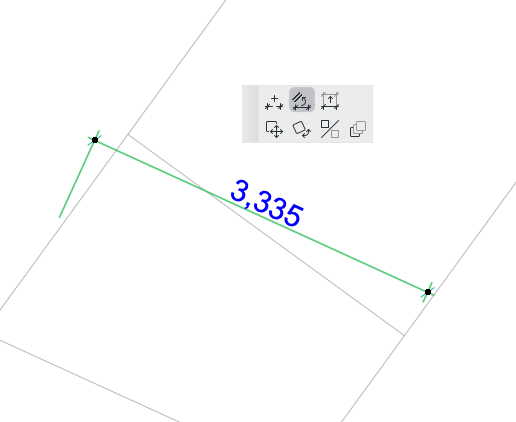

Hey Patrick,
Dimitrius here. That's a nice video - I would just add to this the "align" option, it is handy when you're in a rush and accidentally either put the dimension on a wrong rotation or you just want to correct it afterwards after some adjustments to the model. You just need to select the option and choose another line/wall for the dimension to become parallel to the selected element. I used to use it the most.
