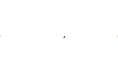

hey all.
whenever i press fit to window button it zoom out to 0.044% no matter what i do in unlock and how all layers. nothing is showing.
can someone suggest a solution.

hey mate.
yeah ive already tried all that before i post it here. nothing is appearing .

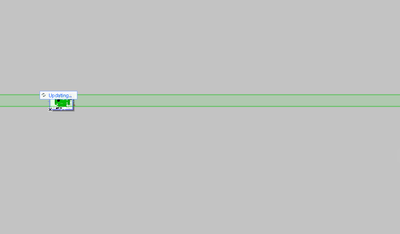

Are you in the plan window or a layout page (your second image show a layout?).

yeah second picture show layout just to show if i place the view (frame to fit) it shows this.
i tried everything, project map and view map shows this. and only on ground floor.
3d is fine and so are other views from the same storey.
i literally tried everything.
If 'fit to frame' is showing like that on the drawing, then that makes me suspect even more that there is something way off in the distance.
If 3D is not affected, then I would say it is a 2D element only in your floor plan.
