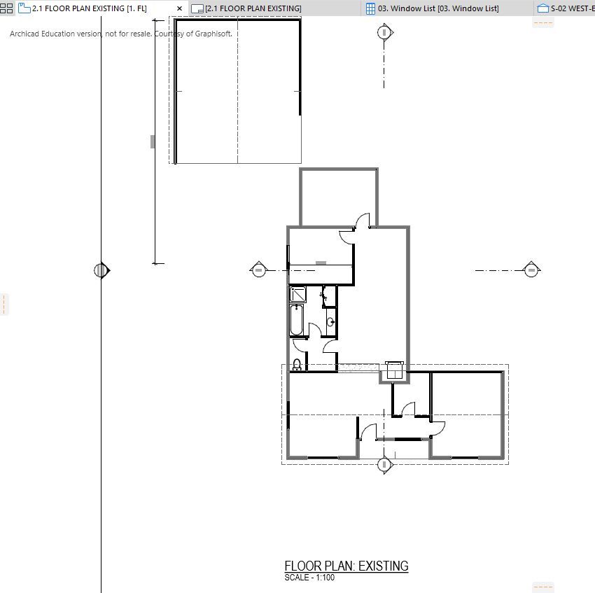

how can I hide section markers on "existing" and "demolition" filters?
designrevellion
Good morning brains trust!
I am struggling to find a way to hide section markers on the different renovation filters. Any tips please?
~Anita (newby)

Lee Hankins
Unfortunately this is a limitation of the renovation filters at the moment. You can’t assign markers (elevation, section etc.) to renovation filters. You would have to control their visibility by layer.

Thanks Lee, I spent hours trying to nut this out. That's a very simple answer! So to create layers, far out, where do I begin. Would you have a screenshot of how you set up layers for three stages of existing / demolition / new?? ~A

If I want to control the visibility of new and existing section and elevation markers I normally create a duplicate layer for each. One named existing and one named proposed then just switch the relevant one on in the combination for the relevant view.

Renovation status for Markers, we are already working on this, indicated here on our road map as in progress - https://community.graphisoft.com/t5/Product-Roadmap/Renovation-Status-for-Markers/idi-p/632887
