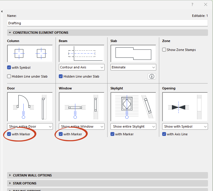

Archicad 28. Drawing a plan, now suddenly all the labels are gone from the doors and windows. Played with the Renovation filters, but none of them show the lanes. How to fix?
2 Replies 2
Have a look at your model View Option settings.
This is 25, but is similar in 28.
Lingwisyer
Guru
Check your Model View Options
