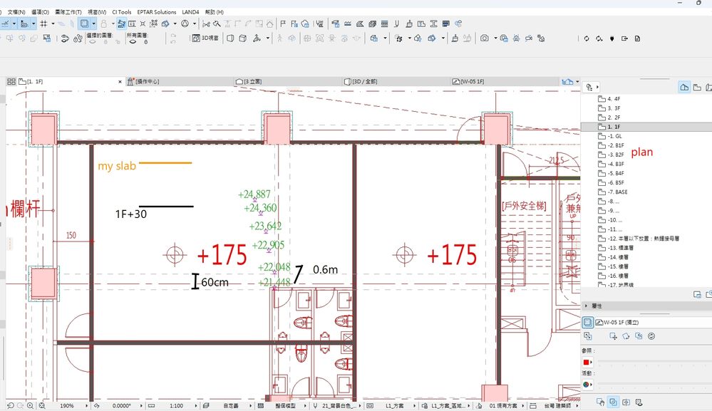

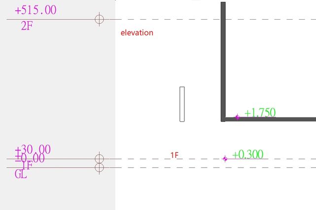

my level dimension becomes weird.
it works like it is place in elevation not plan
when i click high  the dimension follows up
what did i do wrong?

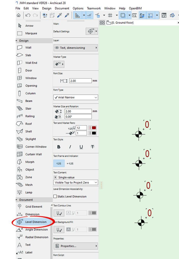

Are you sure you are using the 'Level Dimension' tool?
Lingwisyer
Guru
Wrong tool. You want to be using the Level Dimension Tool, in plan rather than the Dimension Tool.

ps. The Elevation setting for the Dimension Tool just measures the distance up the page from the origin in plan.
KURTLIN
sorry, not English speaker, i thought level dimension tools means i change the dimension to the type that tells height.
didn't notice they are two tools

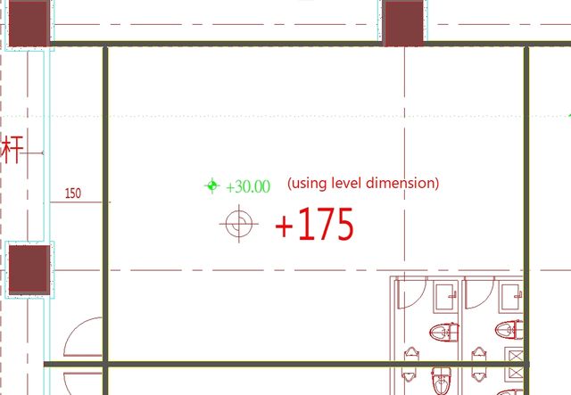

but level dimension can't relate to slab height, right?
it only shows +30.
but the number i want is +175.
i asked my colleague and their dimension tools work fine
but i don't know why mine does not in this file.

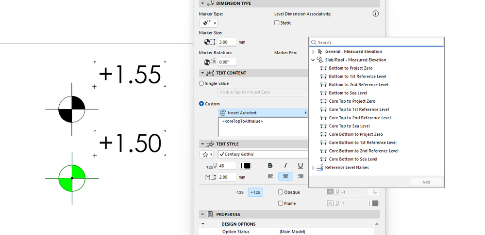

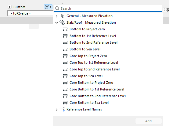

KURTLIN
do archicad 25 have this function?
can't find the options like yours
Autotext items in Level Dimensioning Text is a feature that was not available in Archicad 25. It was introduced in Archicad 26.
