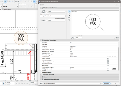

We keep main TW model and detail TW seperated since ages, for different reasons:
- file size, performance
- less TW reservation conflicts
- detail TW is 'outlaw territory'; content is pasted from everywhere (including late '90s attributes...)
- 1:50 main model content seldomly suits details (section through window? No, thanks...)
So: manual text in det markers is 100% NOT an our only option
We use a quite dumb lib element as marker BTW:
