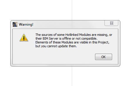

I have problem with the link between drawing and layout is gone normally I open one (pln or pla) project designed in ac 13 or 14 of ArchiCAD 15, see message: BIS server run on our server. Have reinstall ac 15 with the same error Has anybody an idea to solve

The modules must be in the same version as the archicad file. They must also be on the BIMServer. If the latter is not true, the link is not permanent.

Thanks for your response, it is the same version on pln file and linkade modules, as will the ArchiCAD 15 and BIM server
The link between the view set-up and layout (on all layouts and master) disappears when pln or pla file in version 14 is opened in version 15

After you open the main file in 15 and separately each module file in 15 have you relinked the files?
