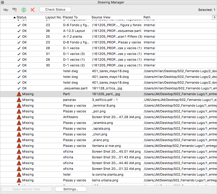

I recently got a new computer and I'm working on a file I began in the old one. I copied my project files to the same location with all the project files but I lost all my link paths because of the different computer name.
before my links where in
/users/*computer1*/desktop/assigned folder/...
I need them to change to
/users/*computer2*/desktop/assigned folder/...
my links are pretty organized and I could manually relink all 90+ of them but I'm wondering if there is a quicker solution.

Hola Jan,
If the links are within the same folder then you can grab them all by "Shift click", right click, select "read from"…

Gracias! Saved me like an hour of unneccesary file selection.
