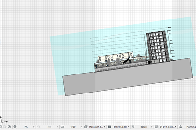

rotated view in elevation ... possible bug
Today a member of the team experienced a weird behaviour ... One of the elevations was rotated . ( in view map and model map ) the levels text , dimensions and levels were fixed horizontal . ( 90 degrees ) exactly the same behaviour of rotating a view ( which is not possible in the elevations , sections window ) ( in layout it was fine) .
and there was no way of rotating it back . later I noticed that this happened after this particular elevation was used as a trace reference of a rotated plan and (switch reference / active ) button was used . the solution was to go to plan and reference that elevation ..rotate the plan view ..then use (switch reference / active ) button .
Not sure that this is a normal behaviour . it happened on a team work file AC13 .

Hi, i have the same issue even when i open from source view which is shown normal itself.
its fixed when i used redefine setting from another normal view!

Hi Nguyen,
I am using 25 but open and repair would mean i have to shut down and reopen a really big file, in todays capitalism I would be happy to avoid loosing 20 minutes.
The issue persists and randomly takes on every so often, for a random selection of views, but redefine seems to correct it, however, it isnt ideal.

Hi Slavica,
From the reported case I mentioned previously, we found that there was a hidden object in the project that messed up the elevation orientation. But I'm not sure whether this is your case. For further investigation, you may want to contact your local support to forward the specific file for investigation.
Did it again. This section appeared normal when working on building existing drawings. I moved the section line slightly to temporarily capture something I needed to adjust and when I opened the section, it was rotated. I'm running 25
However it corrects if I open a section that is displaying correctly and then redefine with current window settings.
