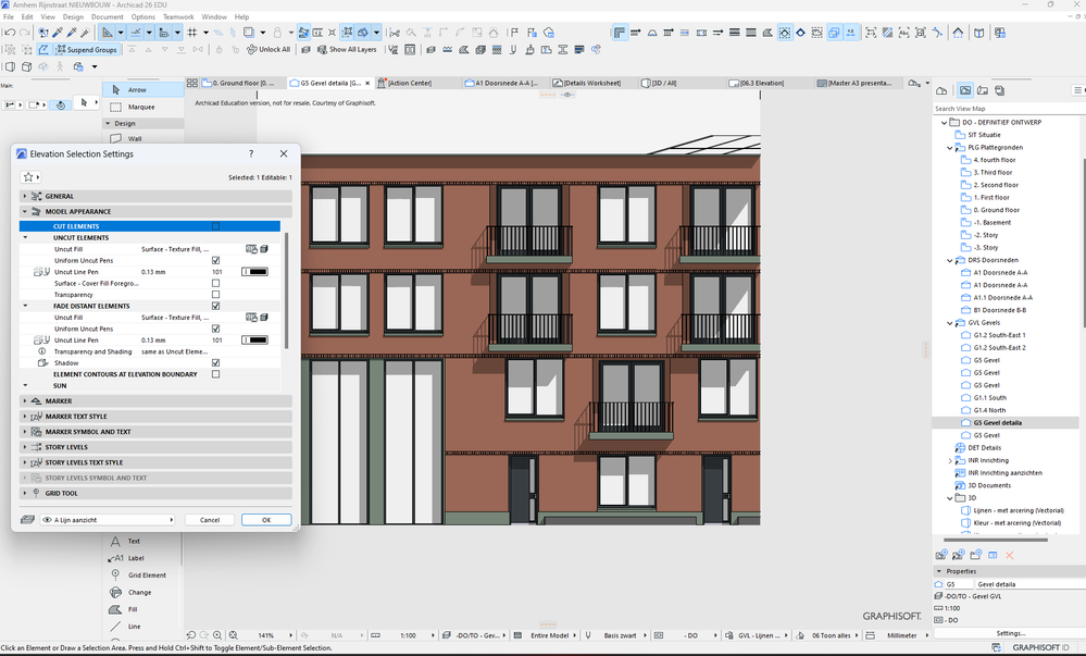

I have a problem with the elevations.
when i change the uncut fill in the elevation setting to rurface texture fill, i can't get the texture. When i change this i get only the color which is provided to the surface. So basically the texture fill isn't a texture but more a surface with a color.
How can i get the texture in my elevation?
I have already put an image with the provided material.

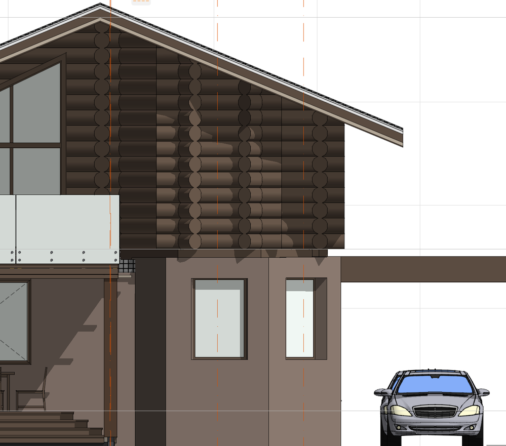

I have the same problem, on facades in texture display mode, the texture is not displayed, but only the surface fill. And fading is not enabled here.

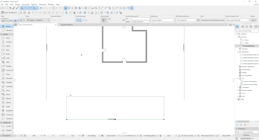

If Barry's suggestion does not give a solution, here is another question:
What happens if you draw another Elevation Line and set Uncut Fills to "Surface- Texture Fill". Does it appear then in your Elevation?
