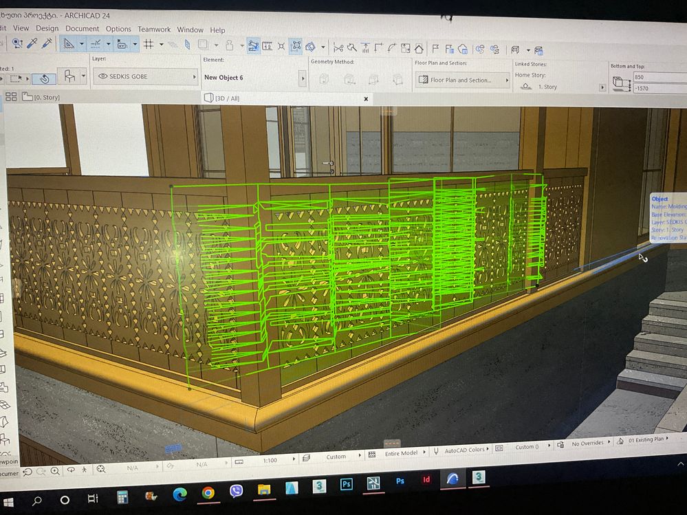

hi,
in Archicad the edges of objects and slabs are broken. can someone help me solve this problem?

Not sure, but are you possibly modelling too far from the origin?
If so, move the model closer, maybe it straightens out this way.

There are only two possible reasons: Your GPU driver has gone bad and you need to update (very rarely the case).
Or you have modeled something very far from the origin (or modeled seperate things with a very big distance between them).
Possibly you have imported a DWG at some point? Those tend to sometimes generate geometry far away.
Please note that this goes for every view! Also independent worksheets.
Meaning you need to check the extent of every view.
After cleaning everything up you also need to close and reopen the file so Archicad can rearrange its internals.
