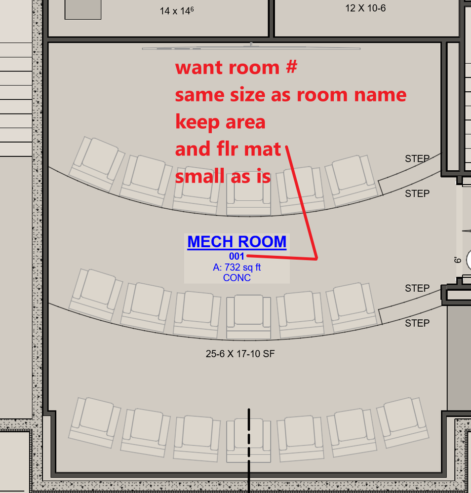

I have 3 questions regarding Zones.
1.  How can I make the room number bigger (same size as room name), but still keep the area and floor material small font as is?

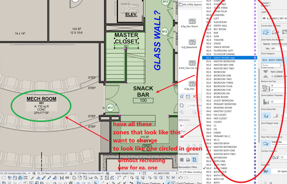

3. I have over 100 room names alreday set up with a zone tag. But I want to modify all of them now  to include additional information. Can I do this globally?
how can i update old labels to look like the label circled in green
