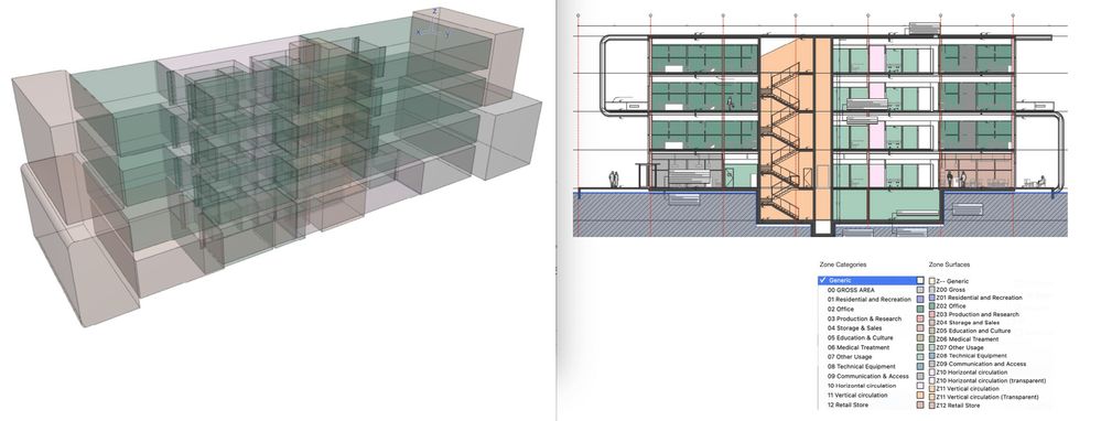

What I've done as illustrated below it to create a series of Surfaces which matches the Zone Cat colour. Each surface is transparent and can be used in 3D and section. If the Surfaces created are transparent they can be view as either solid or transparent depending on GO or Section settings. In addition show well in 3D. Hope this helps.ZonesWithSurfaces.jpg

David Shorter
Firstly there is no direct link between the Zone Category and the Model tab, which is unfortunate.
