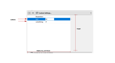

His issue is clearly that the first column can't be read properly.
I have not tested it, but from the screenshot it does look like that the columns are not user resizable when the description and value header texts are empty strings.
Together with the very low overall size of the UI_LISTFIELD causes the first column to be unreadable (all params saying "test..." instead of something distinguishable).

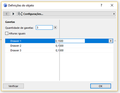

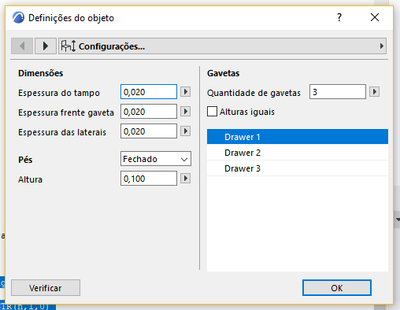

I forgot to show the code. Its a very simple, I only have 2 columns (Drawer, Height) with no icons. So, that being so narrow I thought "I dont need use all window width for that". I used only half-window width (between 250 and 470), but in preview the second column does not appear, nor does the scroll bar. Please pay attention to height.
 UI_LISTFIELD 1, 250, 85, 200, 160, 0, "", ""
FOR n = 1 to drawQtd
ui_listitem n, 1, "drawHeight"+STR(n,1,0), 0, 0, "Drawer "+STR(n,1,0)
NEXT n

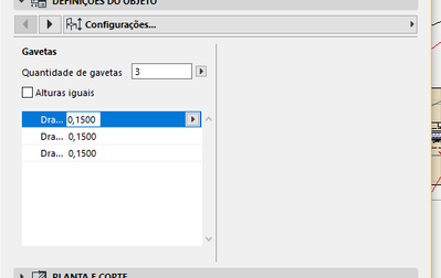

The preview

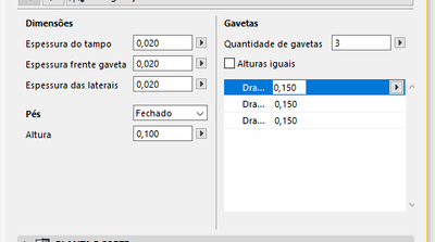

The result
Now we can see both columns (the widths are wrong) and scroll bar, but the height is also different.
Anyway, after a lot of attempts I understood that UI_LISTFIELD only works properly if you use all window width. Or, more than half-window at least.

I think it is more complex than we believe @Runa , I moved the field to left and I had the same problem.
After some tests I realized that the preview completely ignores any length over then 20 at right side. But its okay if everything is okay in the end.
But at the result, the box fitted perfectly, but still with the same column width problem. Even using the headers, you cannot resize the columns. This is very annoying.
My conclusion is that no matter what field size you try, if it is smaller than the full width of the window, you will have an error 😒
