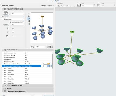

I threw a complex light fixutre together with a cut sheet, manuf. image, and a basic parameter:
"I need a light fixture from the attached cut sheet and image. It needs hotspots for each arm's angle and length. It needs a parameter for pendant length from the ceiling and a hotspot at the mounting point. max polygon count should be 15,000"
I didn't even need to request a 2d symbol, but I have no doubt it would edit the symbol to be whatever I need it to be given a few revised prompts.
I definitely recommend claude for GDL assistance!
object attached, for anyone curious.

oh, and the object it fed me the script for was only 6,000 poly. If I 'morf barfed' this, it would have been easily 20,000 poly, and would have been static, except the hang height! this is a game changer for me!

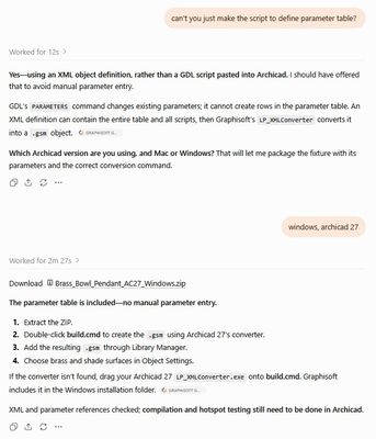

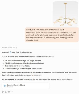

I tried this too with the paid version of Chagpt (by stealing your prompt and image) and it gave me the gsm file directly after one iteration:
It first gave me some instructions on how to copy and paste the scripts and where but then the second time round it just gave me the gsm file.

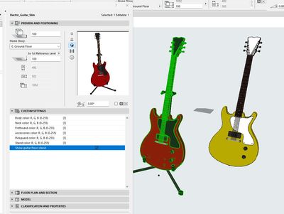

it can make guitars too:

it did indeed write all comments and gave parameter lists, names, and default values!
this was one pass. I copy/pasted the scripts in (master script, 3d, 2d, and parameter). I had about a dozen errors found in the script. 4 were due to a parameter typo on my part. 5-6 were due to a parameter matrix error, also on my part. the few script errors it fed me, it found and replaced when I gave it the error message and line found on.
it became very obvious that I could have fed it any number of revisions; for a custom symbol, symbol text, additional surface break downs, etc.
