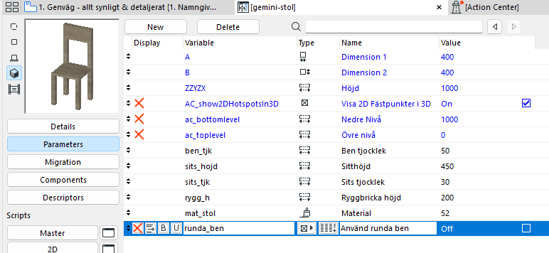

So, today I tried Gemini to do script for a simple chair.
  • It listed all parameters that I needed
  • made simple 2d script with project2
  • full 3D script.
No errors!!!! 😀 Also comments for every part.
AI is learning,
Soon it will take over the world. 🤣

Here is the 3D script. The 2D was just Project2 3, 270, 2
Comments are in Swedish.

Can you remember the AI prompt?
Did you ask for a round or square leg option?
Adjustable seat and back height?
Mr_Snarl
Graphisoft Partner
Graphisoft Partner
Yes, I did 🙂
