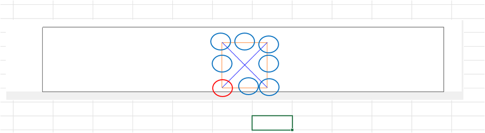

I want to draw an "X" mark for an elevation opening on the label GDL.
ADD2 LABEL_POSITION [2] [1] + LABEL_POSITION [3] [1], LABEL_POSITION [2] [2] + LABEL_POSITION [3] [2]
LINE2 0,0, OPENING_WIDTH, OPENING_HEIGHT
LINE2 0, OPENING_HEIGHT, OPENING_WIDTH, 0
In the case of the above command, clicking the red circle of the opening will place it neatly, but I also want to place the "X" mark in the opening by clicking any of the other (blue circles).
How can I place the "X" mark regardless of the click position of the label placement?

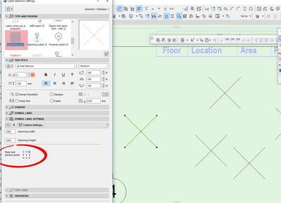

@Nami Furuta ,
A present for you.😀
I just quickly altered a label I had that had a nice visual anchor point picker.
Only active when you don't use the label leader line.
It may not be perfect but should give you some ideas.
The image for that anchor point should be in your default library.
If you don't see this then let me know and I will hunt down the image.
