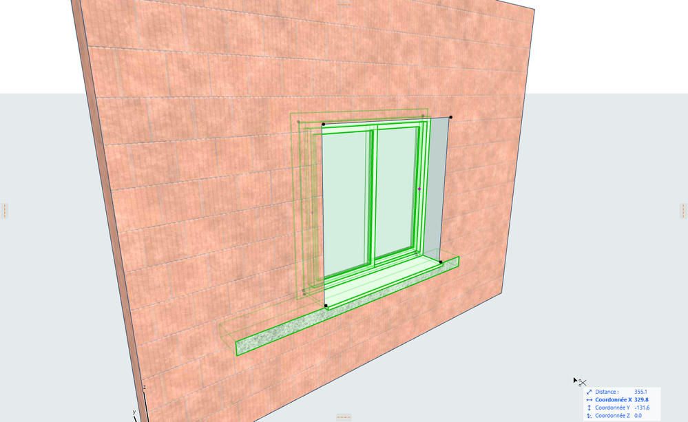

I created a simple box with GDL, this is like a concrete window sill, which should be placed under the sill finish.
I want to link that box as a macro the the default Archicad windows, can someone explain the process please?
What I need:
  • the box is centered to the window
  • the box volume is substracted from the wall
  • I can edit box sizes from window settings box.
Thanks a lot.

So , i called the original window , it works  : Call "Object name " PARAMETERS ALL
Now i called the box macro,
that macro is supposed to create a hole inside the wall ,
the 3D code is the following
ADDX -A/2
ADDY -Ha-0.02
! ADDY ...
BODY -1
    BLOCK A, Ha, Pa
BODY 1
DEL 1     ​
Cavity is not substracted here
How can i fix it  please

So your box macro has a WALLHOLE in it? Do note, that you will have to replace your wall finish where it overlaps with your WALLHOLE or WALLNICHE.

i found in the gdl manual that i can use body -1 command to do subtraction , i didn't use wellhole because it creates a hole throughout the wall , wallniche seems to be the best choice, but i didn't figure out how to use it .
All i need is :
a box that substract a part inside the wall
and
A shape generated from a complex profile ( from profile manager ) that can do the same job

Hello again !
And here is the result :
with this technique i can add some nice functionalities to the default window ,
Thanks to @Bruce  for his priceless YouTube tutorials .
I'm not sure about that serie of DEL1 , but if it works don't touch it 😂🤣

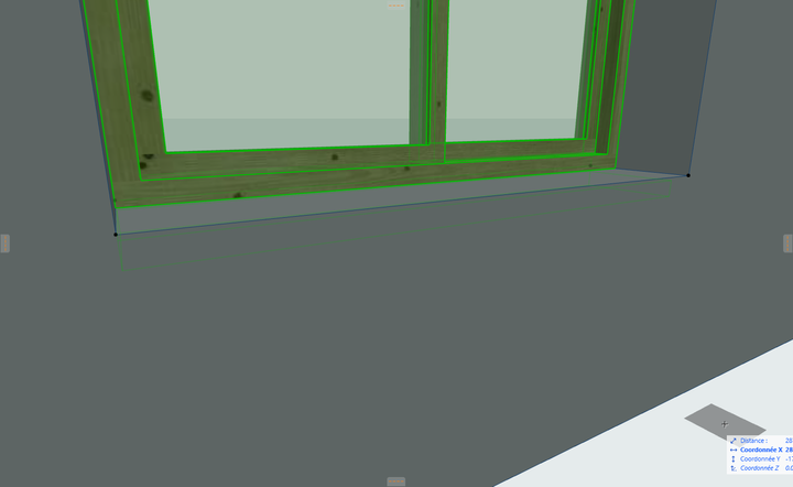

Hello again ,
Finally it works , at the moment haha
one small problem , it doesn't flip when i change the wall reference position

There are 8 possible variable combinations for the opening direction. There is a post somewhere regarding it. SYMB_MIRRORED, SYMB_ROTANGLE and WIDO_REVEAL_SIDE. So you will need to flip your additions in accordance.
https://gdl.graphisoft.com/gdl-basics/simple-doors-and-windows/

The DEL 1 undo the previous transformations (ADDX, ADDY, ADDZ) so they are removed after the WALLNICHE is made. They could be replaced by a DEL 5 in this case, but as you said "if it works don't touch it".
