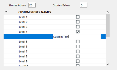

Hi All,
How might you go about creating a scrollable UI list that has 3 columns based on two array parameters? A [i][2] text array, and a [i] boolean array.
I currently just have it adding lines as it loops based on the top input, but that can hit the limitations of the bounding box. I can extend it to two columns, which would meet the majority of use cases, but I figured it would be better to make it more flexible.
Ling.
ps. Though, now I get array dimension errors since I merged one of the parameters into a second column of the array...

I decided to use ui_listitem and got it working within a loop, though it does not preview properly with x/y being inverted... The down side is that my text input is on a second line below the checkbox.
ui_listfield 1, 10, 60,	432, 200
		ui_listitem		1,		1,	"",							0,	"",	"Storey Levels"
	FOR i = 2 to (sg_noStoreyAbove + 1)
		IF sg_base_toggle then
				IF i = 2 then
						name = "Reference Offset"
					ELSE
						name = sg_name_prefix + STR ("%2.0", i-2)
				endIF
			ELSE
				name = sg_name_prefix + STR ("%2.0", i-1)
		endIF
		ui_listitem{2}	i,				1,	sg_styToSty[i-1],				1,	"",	name
	next i
		ui_listitem		i+2,			1,	"",								0,	"",	"Basement Levels"
	FOR j = 2 to (sg_noBasement + 1)
		name = sg_nameBase_prefix + STR ("%2.0", j-1)
		ui_listitem{2}	i+2+j*j,		1,	sg_basementHTs[j-1],			1,	"",	name
	next j

Hello @Lingwisyer ,
I have one way of doing it but it isn't really a scrollbar, just the UI redisplaying lines depending on a specific position.
Using your 2 array parameters :
ui_array_bool as a 1 dimensional array
ui_array_text as a 2 dimensional array
Requires 3 additional parameters :
ui_pos as an integer param
ui_checkbox_plus as a bool parameter
ui_checkbox_minus as a bool parameter
In Main script :
LINES_MAX = 5 ! Max number of displayed lines
POS = ui_pos
LINES = vardim1(ui_array_bool)
if LINES > LINES_MAX then
	NUM = LINES - LINES_MAX
else
	NUM = LINES_MAX
endif
MINI_UI = -int(NUM)
! Increments, decrements position and update checkboxes
if ui_checkbox_plus then
	POS = POS + 1
	parameters ui_checkbox_plus = 0
ENDIF
if ui_checkbox_minus then
	POS = POS - 1
	parameters ui_checkbox_minus = 0
ENDIF
! Prevents the pos to go out of the min and max possible position
if POS < MINI_UI then
	POS = MINI_UI
else
	if POS > 0 then
		POS = 0
	endif
endif
ui_pos = POS
if not(LINES > LINES_MAX) then
	ui_pos = 0
endif
In Parameters script :
parameters ui_pos = ui_pos
if ui_pos = 0 then lock "ui_checkbox_plus"
if ui_pos = MINI_UI then lock "ui_checkbox_minus"
In UI script :
x0 = 5
y0 = 5
dy = 20
x = x0
y = y0
	ROW_MIN = (LINES - LINES_MAX) + ui_pos
else
	ROW_MIN = 0
endif
ROW_MAX = LINES + ui_pos
for row = ROW_MAX-ROW_MIN to 1 step -1
	ACTUAL_ROW = ROW_MAX + 1 - row
	ui_outfield		"Level "+str(ACTUAL_ROW,1,0), x, y : x = x + 50
	ui_infield{3}	ui_array_bool[ACTUAL_ROW], x, y-4, 20, 20 : x = x + 20
	ui_infield{3}	ui_array_text[ACTUAL_ROW][2], x, y-4, 20, 20
	x = x0
	y = y + dy
next row
ui_infield{3}	ui_checkbox_minus, x+100, y0-4, 20, 20
ui_infield{3}	ui_checkbox_plus, x+100, y-dy-4, 20, 20
