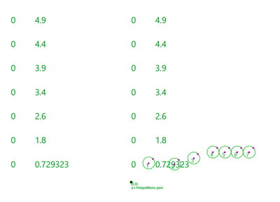

I am creating an algorithm for graphically adding/subtracting elements of an array (dim_xy[ ][ ]) using hotspots (from the hot_mnu[ ] array).
It seems to me that adding new elements to the dim_xy[ ][ ] array works OK:
HotspotMenu1.gif😊
But removing elements from the dim_xy[ ][ ] array unfortunately does not work properly because the last removed element of the array is restored:
HotspotMenu2.gif😕😕😕
I noticed that for removing an element from the dim_xy[ ][ ] array to work, I have to click a hotspot not related to the hotspots hot_mnu[ ] before removing, i.e. remove in two stages:
HotspotMenu3.gif😎😕
Where is the error? Can someone help?

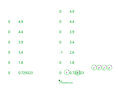

the GLOB_MODPAR_NAME is the problem
when changing the value it thinks the script runs, but it runs this happens
step 1
step 2-remove point 3
step3 remove another point, i selected  new point 4
because another parameter isn't actually modified, the script does not fully run (the parameter operation does not run and inject the values back to the library part parameters, only the temporary used variables are modified), and the ghost points stay.
this problem happens normally with editable hotspots, as you can edit parameters without going to the settings dialog box.
if you edit a variable other than the subtraction node then the script runs correctly (the parameters are injected back to the library part parameters) and the nodes are correctly set after this.

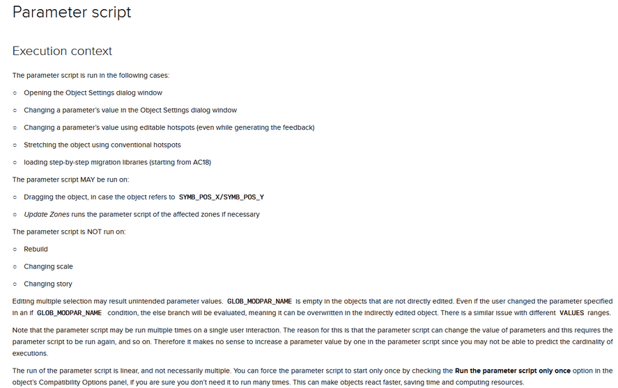

https://gdl.graphisoft.com/gdl-style-guide/script-type-dependent-recommendations
"Even if the user changed the parameter specified in an if GLOB_MODPAR_NAME condition, the else branch will be evaluated"
this is what happens for the 2d output.
(but the parameter script commands are not evaluated for the instance where the parameter is not the subtraction parameter, so no update to library part parameters)
when you open the settings dialogue box, the parameters part of the script is run and then the ghost points are deleted, so everything appears to have worked.
