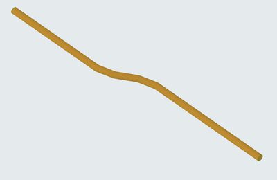

LeeJaeYoung
i would like to do this
But the reality is like this. ^^
TUBE 2,8,1+2+16+32,
0,0,901,
0.1,360,4001,
-1, 0,0,0,
0,0,0, 1,
3.230,0,0,1,
3.757,0.150,0,1001,
4.330,0.505,0,1,
4.8757,0.656,0,1001,
8.888,0.656,0,1,
8.888+1,0.656,0,0
What's wrong?
I just want to put smooth curves.

julienK
center point doesn't allow additional status code. It has to be 900.
Last parameter on  each line is  not  status code  like other functions.  Its the  angle of the profile relative to the path.
It should be 0 everywhere
TUBE 2,8,1+2+16+32,
0,0,900,
0.1,360,4001,
-1, 0,0,0,
0,0,0, 0,
3.230,0,0,0,
3.757,0.150,0,0,
4.330,0.505,0,0,
4.8757,0.656,0,0,
8.888,0.656,0,0,
8.888+1,0.656,0,0

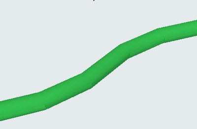

Bruce
A TUBE command isn't like a PRISM command.  You must define every coordinate along the path.  When you do curves, the maximum angle you can 'bend' and still keep a smooth transition is 15° - any sharper than that and you will get lines at the bends.
The below code will model a rectangular hoop with rounded corners.

LeeJaeYoung
Isn't this a straight path?
Can't you make a smooth pass like a 3D modeler?

Bruce
Yes, this is a straight path from point to point.  You can't make a 'smooth' pass like you can in Rhino (for example).

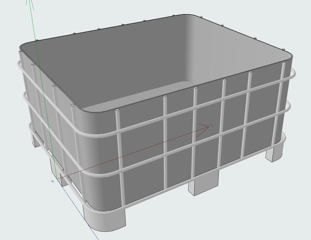

Jochen Suehlo
Moderator Emeritus
Example tube ring.
