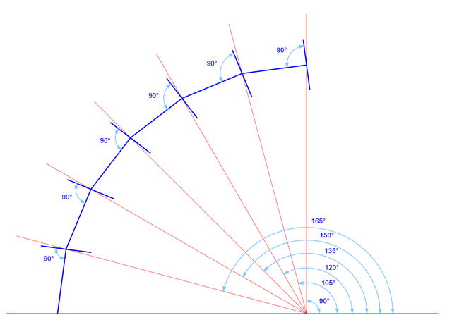

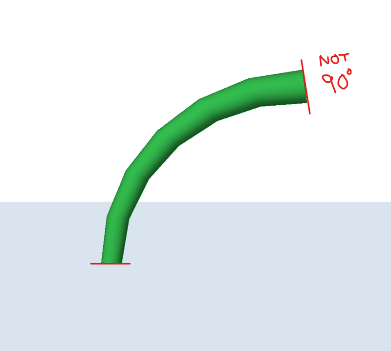

Hi All,
As the title suggests, I am trying to sweep a circular profile along an arc path, however the sweep end angle is not exactly 90 degrees to the sweep start angle (see image below). I also know that the tube command does something similar, I wanted to know if there is a way to get this to finish at exactly 90 degrees, similar to the way the elbow command does. See code example below:
!Variables
spoutRadius = 0.016
spoutArcRadius = 0.300
!Sweep
sweep 2, 7, 0, 1.1, 1+2+4+8+0+0+0,
0, 0, 901,
spoutRadius, 360, 4001,
0, 0, 0,
spoutArcRadius+spoutArcRadius*cos(165), 0, spoutArcRadius*sin(165),
spoutArcRadius+spoutArcRadius*cos(150), 0, spoutArcRadius*sin(150),
spoutArcRadius+spoutArcRadius*cos(135), 0, spoutArcRadius*sin(135),
spoutArcRadius+spoutArcRadius*cos(120), 0, spoutArcRadius*sin(120),
spoutArcRadius+spoutArcRadius*cos(105), 0, spoutArcRadius*sin(105),
spoutArcRadius+spoutArcRadius*cos(90), 0, spoutArcRadius*sin(90)

I have not worked with this GDL command for a long time, but you may have to change the angle value of the last line from 90 to 75 because your desired value (90) is the bisector angle of you last two values (105 and 75).

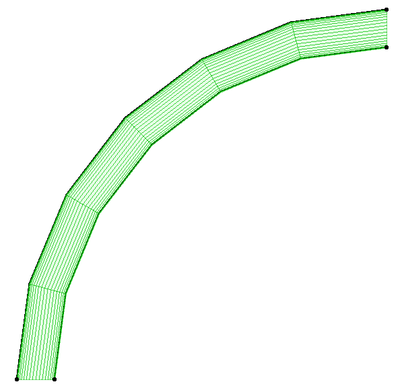

Hi @Laszlo Nagy  ,
Thanks for your response, this worked, however the divisions of the elbow are no longer equal (see image below). The preference would be to have equal divisions in the sweep similar to an elbow.

I have checked the GDL Reference Guide:
https://help.graphisoft.com/AC/27/INT/GDL.pdf
It says:
The cross-section at point (xi, yi, zi) is perpendicular to the space curve segment between points (xi-1, yi-1, zi-1) and (xi, yi, zi).
where
xi, yi, zi: coordinates of the path curve nodes.
This is how the cross sections are calculated per my understanding:
So, at each point of the space curve, Archicad will take that point of the space curve, plus the previous point of the space curve, draw a segment between them, and the cross- section will be perpendicular to that segment and will be generated at the end of the segment.
This I think is counterintuitive to what one may think because I for one supposed that the cross section is generated at the midpoint of each segment, not the endpoint. Because of this, I am not sure I can recommend you a way of achieving this using the SWEEP command because if at 90 degrees, you now want to generate a very short horizontal segment, then the result may be that the SWEEP will become self-intersecting.
So, based on these, I would suggest that you try to use the TUBE command to achieve this. With the TUBE command, the cross section is generated at the midpoint of each segment, plus, if we say that the indexes of the path nodes are from Node 1 to Node m, then you also need to define a Node 0 and a Node m+1 of the path, using which you will be able to control the direction of the first and last segment and will be able to achieve your desired geometry, I think.
For detailed info on the TUBE command, check the GDL Reference Guide.

But a TUBE does not scale each segment smaller or larger as can be done in a SWEEP.
There is TUBEA, but I still don't think that is the same.
Might just need to extend the SWEEP and then cut the end with a cutting plane.
Pertti Paasky
Start with 180 degrees, and the first leg should be half of the others. This is a matter of geometry.
