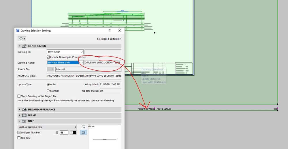

Hi All,

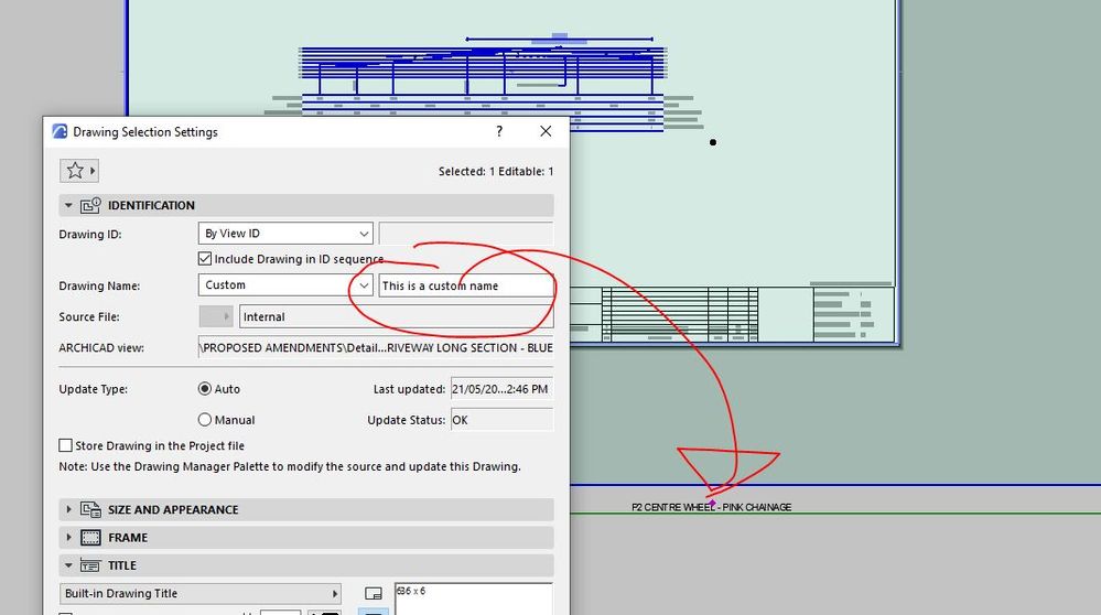

I am having an issue, when I add a new drawing to a layout they are all coming on with the same name. The drawing name in the "Drawing Selections Settings" dialog is set to "By View: Name only" and it is still coming in with the wrong name. When I change to "Custom", nothing changes.
Old drawings in the job are fine, and I can update and change those names as I wish.
I have deleted the layout and created new ones, I still can not change the name.
At the moment, the only thing I can do is turn the drawing title off and use text and lines, but I prefer to use the built in drawing title.
It is only happening on this one file, not on other files. This is an old job, I started back in 2021.
Any ideas?
Solved! Go to Solution.
2024-05-21 05:02 AM
Ok, I just figured it out - The built in drawing title on this file must be glitching.
I changed to the Framing Title 25, then back to the Built In Drawing Title, and it seems to have reset itself.
Thanks
