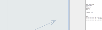

Hello,
I have set a subroutine with a custom 3d object which it shows as it should in 3D, the problem starts when I use a For_To_Next operation, the 3D object disappears totally.
If I use a more simple object the For_To_next works.
Calling the subroutine alone it works:
When For_To_Next is enable, nothing shows:

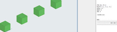

If I use exactly the same For_To_Next with a simple block object, it works:
I'm clueless about what is happening.
Juan

Try to use quotation marks for the subroutine id ("400"). This is just a wild guess.

The answer is probably in the subroutine itself.
What happens, if you put the block in a routine?.... Divide and Conquer!
Lucas Becker | AC 27 on Mac | Graphisoft Insider Panelist | Akroter.io – high-end GDL objects | Author of Runxel's Archicad Wiki | Editor at SelfGDL | Developer of the GDL plugin for Sublime Text
If you post the whole script it would be easy to know what's happening.
But the first comment is likely the solution.
`gosub 400` (which is totally valid!) and `gosub "400"` are different things, tho.
And what makes this unlikely is that the single `gosub 400` outside the loop works.
As mentioned, without the whole script everybody is blind.

I just tried by putting the BLOCK in a subroutine and that worked fine.
So I would suspect something in the 400 subroutine.
Did you forget the RETURN maybe?
I will strip down my script and I will share it.
Thanks, I double checked and there is a return statment.
Will do, didn't think about it.
