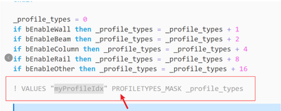

Hi there,
Please check attachment.
This GDL works in AC26 to pick up a profile in current pln file.
But in AC27 none profile can be read from the file. PROFILETYPES_MASK ni not working
Regards,
Mark

Funfun Yan
Maybe it is a bug.
A bug or a change in the command that I haven't read about yet.
I have an object that uses profiles and works fine in 26.
But in 27 the list of profiles is blank (I haven't been using 27 yet so haven't noticed).
The object still works and the one available (default) profile is fine.
If I use a different profile in 26 and then copy & paste that to 27, it will show only that new profile.
And another odd thing is, if I open the script and look at the parameter list in 27, it appears to be working just fine.
Peter Baksa
This is a bug, I will report it.
The problem is with the UI. If you add a graphical UI using ui_infield for the profile parameter, it will work.
