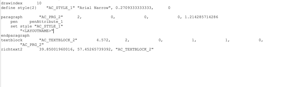

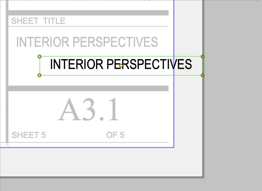

hmmm... saving autotext using <LAYOUTNAME> results in a 2d script using "<LAYOUTNAME>"; and the resulting object definitely pulls the layout name from the layout that object is placed on...
screen shot of script and placed object attached...
what are you saving the script as? haven't tried drawing title and/or label, but it seems to work on my end.

"<LAYOUTNAME>" actually works; I think it may just be a misunderstanding of globals and where they can pull from... or over complicating; not sure what the end goal is for parameter = <GLOBAL>
