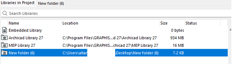

I just added an old .win object from 2003, into the library of an Archicad 27 file, it reads it fine, the GDL code of old objects still works in newer versions of Archicad, so they should work unless it requires an API.
i made a new folder,
New Folder (6) on my desktop
added the .win file into the folder,
then added the folder as a library,
the object appeared in the windows tool.
Awesome. It works. Thank you very much.
