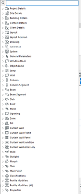

Hi there,  is there a way that I can see all listed autotexts?
@Domagoj Lukinic wrote:
Hi there,  is there a way that I can see all listed audiotexts autotexts?
I am not quite sure what you mean.
There is no list that you can print out if that is what you want.
Just expand the list you show in your image and you will see them all.
Better still, just start typing something in the search at the top to see what might be applicable for what you need.
Domagoj Lukinic
No no no, I was asking is there a GDL object like Joachim Suehlo made that has a dropdown menu like that one that has listing of all autotext-s like property's

Hi there, I would need list of custom property's and general parameters...
