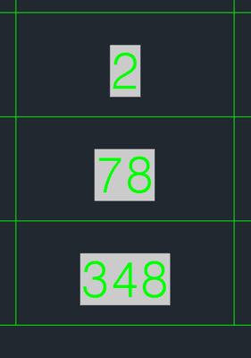

The figure below is a table supported by autocad.
It's almost like Excel. calculation is possible.
It is simply a block list made with Autolisp.
I think it would be nice to have something like table in Archicad and revit.
this is 49 * 1 = 49
this is sum(348)
