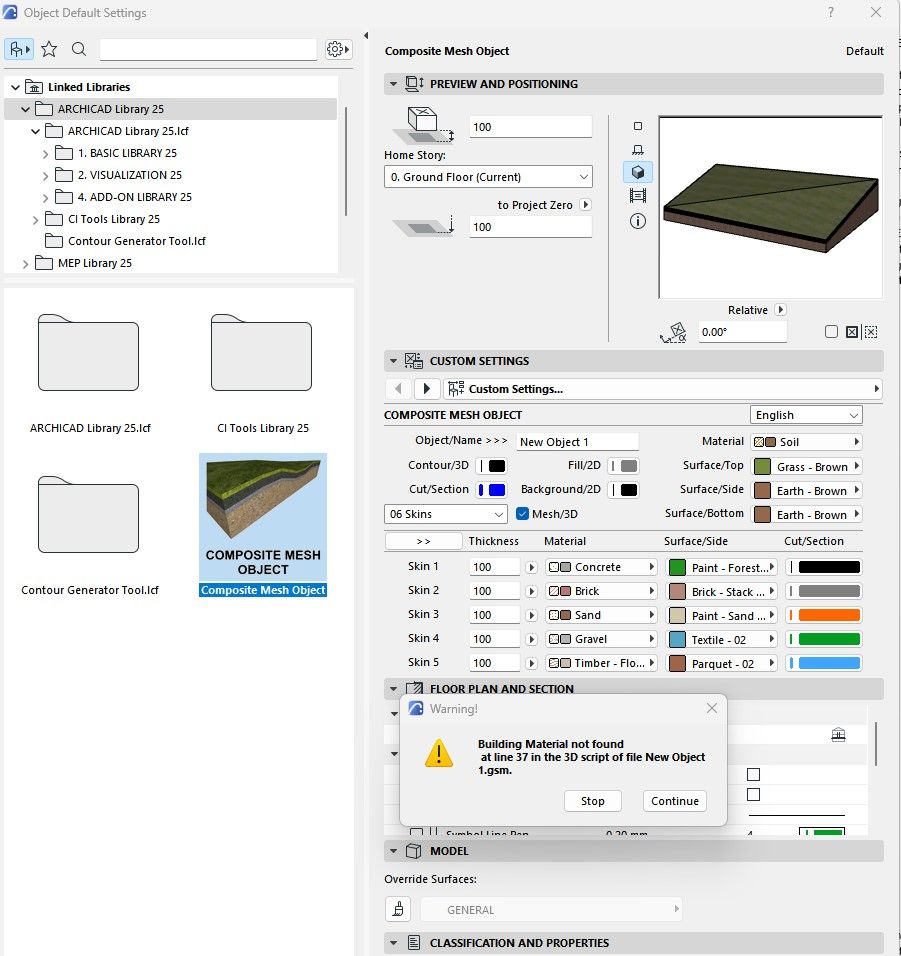

Any help would be appreciated. I am constantly getting this error message for both 25 and 26 even in a new file.
Thanks.

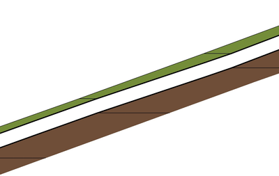

I would steer clear of the mesh to roof tool, simply because when in floor plan view your once smooth mesh will be a series of roofs. A much simpler and cleaner way to do it is to simply copy the 1st mesh, drag it your desired dimension down, change the material to whatever. THEN, copy that mesh down a desired amount and turn it into soil.
gZax
I confirm that the skins are not visible on sections in AC 28 and 27. Any thoughts???
gZax_0-1726228887860.pngAC26
gZax_1-1726228921190.pngAC28
Giorgis
AC27 Intel Mac - Ventura
gZax
Ok after some digging I discovered that v9 works fine with Archicad 27. I started from that version added all the previous translations plus Greek.  I also checked this version with AC28 TP and it works. Skins now show in Sections on newer Archicad versions.
AC28
PS: Someone with better knowledge may have time to compare this version with the versions 10-12 of the object. I am curious to find what exactly broke the functionality. By searching docs in GDL Center I didn't find any reference about changes in GDL versions in  that would justify this behavior.

Thanks @gZax .
The objects is not giving errors any more!!!
What is missing from the settings are the options for 2d fill on the floor plan. Any chance for this addition?

You have to save the mesh object with surface fill enabled on the floor plan settings to be saved inside the 2d script. This is called by the Composite Mesh Object.
Wait for my next version... I have it half.baked for override fill on floorplan and it works fine. It needs some work on translations and some gui and parameters sripts...
