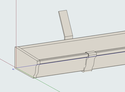

I'm currently working on a library file for the company i work for. I have made a parametric gutter with custom materials if i open this file in a other project the gutter losses all the materials. How do I fix this problem so that other companies who want to use this library do have materials to use the object?

You can DEFINE the materials in the object or create a MASTER_GDL file and DEFINE them in there.
This can cause problems with attributes though, so be careful.
Other companies may not want your materials.
All files in your company should be ideally started from the same master template, so should have all the correct attributes.
If not you can import them from the template.
Obviously update your template with all the attributes (material) you need.
If you are making this object for other companies, you should really work with the default attributes (materials) in the default Archicad template.
Then let the other companies worry about what materials they will use.

Thanks Barry, I fixed the problem but now my model is working with the correct materials in GDL 3D view but not in Archicad 3D model view.
Do you know how i can fix that?
EDIT : I found my problem. It is because i use a CPRISM_{3} shape. Does someone have an idea how i can fix that?

I already fixed the issue. I needed to use CPRISM_{4} instead of CPRISM_{3}.
