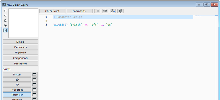

My suggestion would be as follows:
Create an array parameter in the parameter field, e.g. ‘switch’.
You can enter the size, i.e. the number of array indices there manually, but you can also control this dynamically in the parameter script.
Let's assume you enter 6 fields (rows).
Then you write into the parameter script:
VALUES{2} ‘switch’, 0, ‘off’, 1, ‘on’
This command then applies to all sub-array parameters.

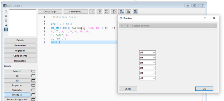

In the user interface, you work through the whole thing with a loop:
FOR i = 1 TO 6
UI_INFIELD{3} Switch[i], 100, 100 + (i - 1) * 25, 80, 20,
8, ‘’, 2, 2, 0, 0, 20, 20,
1, ‘off’, 0,
2, ‘on’, 1
NEXT i

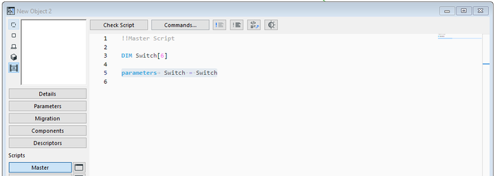

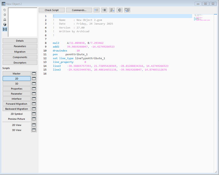

i have tried to replicate the error in a new blank object.
i drew 2 lines, made them into an object, then copied your code in:
i repeated your code:
parameters
master
i added a push back of the parameter array back into the object parameters,
DIM Switch[6]
parameters  Switch = Switch
this updates the size of parameters to correct array size

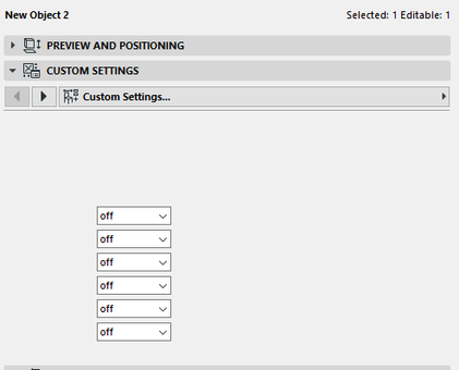

automatic code created from archicad
parameters
interface
click on preview button
when open the object and change to the graphical interface window,
or changing to the parameter script
as an array, the values are not seen in the parameters list unless you open the array
I hope this helps.
