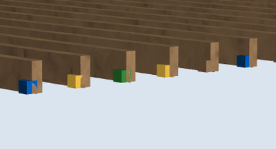

Hello,
I have a simple block using FOR – TO – NEXT to duplicate it, is there a way to add a random texture origin to each duplicated so there is no visible texture repetitions?
Juan.

Yes, you have to move it along X axis to change.
Using bare SYMB_POS_X as the seed is predictable, it might not look good with repeated objects. The % trick works well when the changes of the dividend are huge relative to the divisor. For a huge dividend you need a huge seed.
There are two ways to work around this:
  • mix up SYMB_POS_X, SYMB_POS_Y, their integer and fractional parts
  • use SYMB_POS_X to get a random number in a huge range which you can use as seed

Yeah... need an internal origin version of SYMB_POS_X. The material will change as you move the entire object around....Would have thought that multiplying it by a value that changes every loop would work, but apparently not...
Lingwisyer
Guru
So, I inserted a text output after the material line with the expression of the the randomised array output, and each iteration through the loop gives a different number and has a different material applied to it, so it does work. It is just for some reason not applying to my prism_cylind or cpism_{2}... I thought maybe group might be affect the interaction, but moving the command to within the group did not change anything...
Ling.
ps. I put my test text and shapes in a group, and they all became uniform...
pss. Solved.
PLACEGROUP CREATEGROUPWITHMATERIAL (Square_Top, 2, 1, mat_array[int(rnd(abs(iDis)) % mat_count) + 1])
This does add ALOT of lines though...
