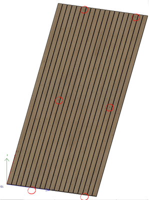

Hello,
I have a simple block using FOR – TO – NEXT to duplicate it, is there a way to add a random texture origin to each duplicated so there is no visible texture repetitions?
Juan.

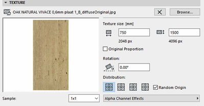

Is it rotated? It is a bit hard to see in your image as your texture size is significantly bigger than your board size...

Yes, in my case the texture doesn't "follow" the board size. But the texture is not rotated.

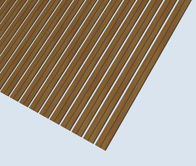

Try this ...

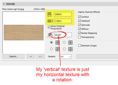

Just use your surface material.
I have only offset in the 'y' direction.
And maybe turn the 'random origin' off in your surface material (mine is off).
board_width = 0.100
board_gap = 0.010
N1= CEIL(A /(board_width+board_gap))
FOR H=1 TO N1
GOSUB 20
ADDx board_width + board_gap
NEXT H
DEL TOP
END
20:
MATERIAL "Timber_Pine - vertical"
block board_width, B, ZZYZX
texture_origin_y = RND(10)
GOSUB 100
RETURN
100: !!texture mapping
VERT 0,0+texture_origin_y,0 !Origin
VERT 1,0+texture_origin_y,0 !X direction
VERT 0,1+texture_origin_y,0 !Y direction
VERT 0,0+texture_origin_y,1 !Z direction
COOR 2+256,1,2,3,4
body -1
RETURN

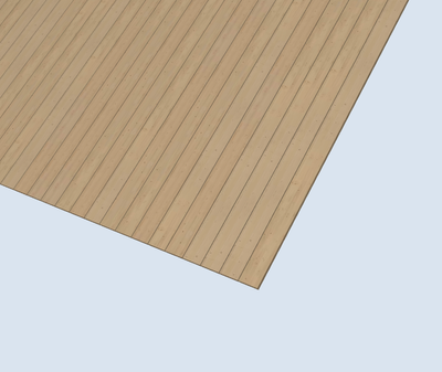

Mind you, if you texture is big enough you may not even need the VERT/COOR gosub.
You can see here the repetition without VERT/COOR - not great but it is OK.
If you are using the VERT/COOR gosub, you are really just using the first edge of the material.
I guess you could add in a 'texture_origin_x' offset as well which I took out of my example.
Your texture only needs to be one board width if you do use it, but a bigger texture is fine because you can use it for other situations as well as in sheeting rather than boards.
