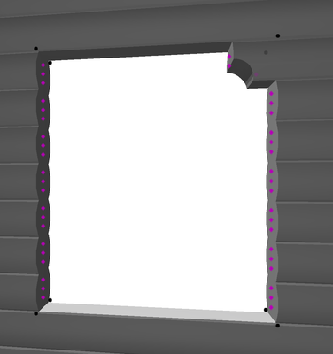

Here's a screenshot to show what I was after: Hotspots / aperture shape based on logheight and starting logheight. I'm sure those will be derived from the add-on, so no more dabbling in gdl for that purpose.
Thank you very much for the replys!
