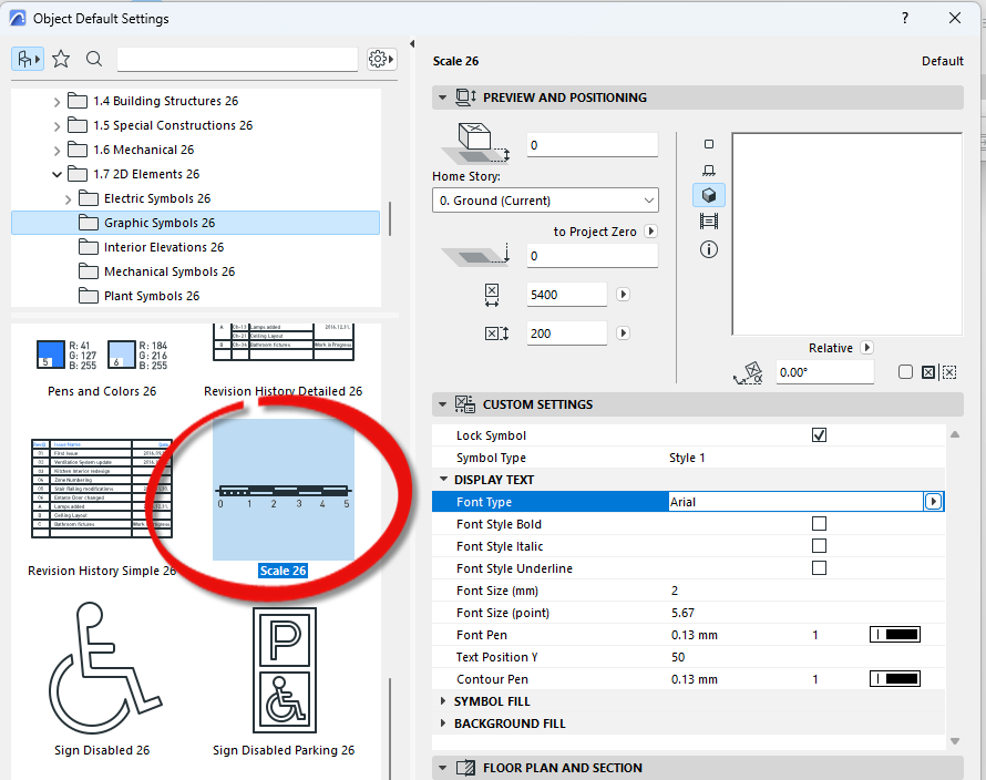

You mean this scale object in the default library?
If not, you will need to show us which one.

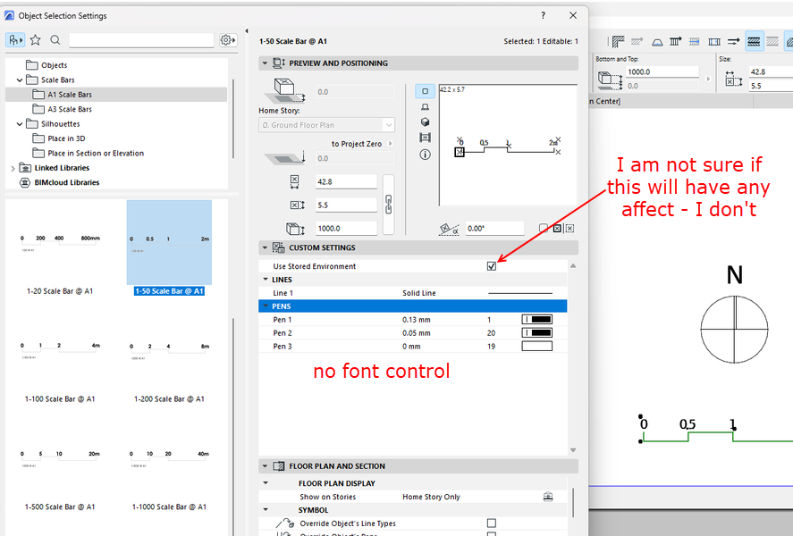

ArchiRoss
Hi Barry,
 The below is a screenshot of the object settings, with one of the offending objects highlighted on the underlying window on the right.
OK thanks.
I can see these objects have no control over the font used.
If this is not how they normally look, all I can assume is you do not have the font installed on your machine.
To edit, select a placed object.
Press CTRL+SHIFT+O at the same time.
This will open the editor.
In the 2D script you should find a line that starts with "define style..."
The part I have circled probably has a font name in quotes - i.e. "Arial".
You can change that name to the actual font you want to use.
Then save and close the editor.
This will change just that one object in your embedded library.
You will need to do the same for all of the other objects.
Then save them and load them in any other file that has these objects.
Or better still, save them out into a folder called "Office Library" (or similar) on your local hard drive or network server if you use one.
Now you can load that folder as a library in any file, instead of having them in the embedded library of just one file.
ArchiRoss
What a star you are Barry!
That script change worked perfectly. Thank you very much.
Ross
