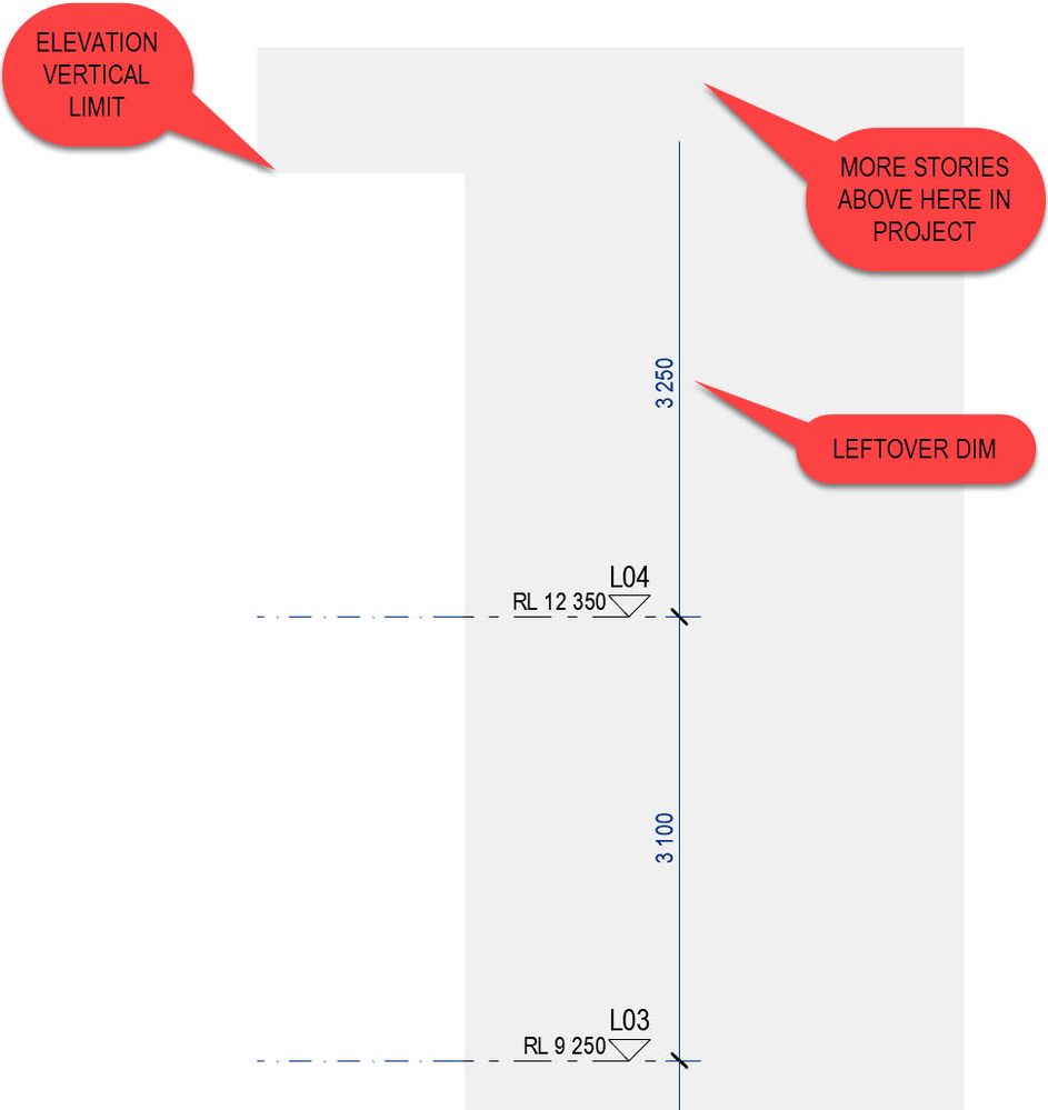

@Barry Kelly : it's not the story marker per se that I'm trying to control, it's the story-to-story dimension.  Given it runs when the story marker does, we get this leftover dimension - see image.  I can control this with a user-set limiting of stories, but that's another non-automated setting.  I'd like to better control that if I could.

Ahh I'm with you now, I did not fully understand your goal.

But are you adding the dimensions manually yourself?
I think Bruce is building the dimensions into his markers from the way his post reads.
ryejuan
i see, i understand now. he created his own markers that will automate dimensions instead of him manually doing it. something similar to the way it does with the grid lines. interesting saves you a lot of time. like a toggle that will turn on distance dims and levels. 😁 i hope Graphisoft will incorporate that in future versions. 😁
