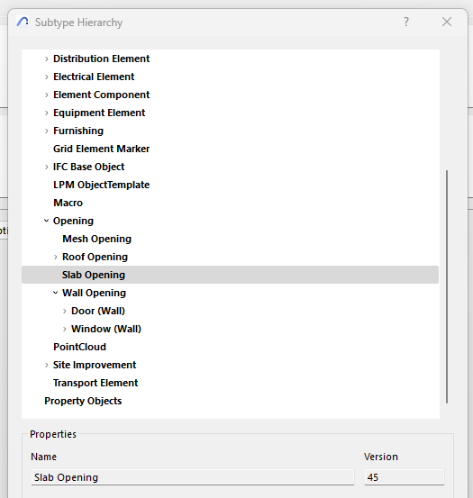

Slab opening subtype
Can the 'Slab Opening' subtype be used in any meaningful way?
I assume it's intended to function similarly to the 'Skylight' subtype.
I'd like to script object for slab niche / slab coffer. I don't want to use SEO.
There was a query about this back in 2004, has there been any update since then?
https://community.graphisoft.com/t5/Libraries-objects/Subtypes-Mesh-opening/m-p/89435#M39916
1 Reply 1
It is just a placeholder unfortunately, and probably nothing will happen as we have opening tool.
