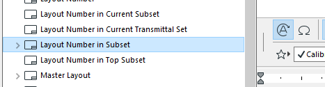

I have a fully automated office stamp object that is placed on the Master Layouts. I am now being asked to also include the layout number within a subset. This is possible using autotexts in regular text boxes. However, I want to incorporate this into my object. Is it possible to obtain the 'autotext list' in a user interface of a GDL object?

Thank you Yves!
I was clearly overthinking it. This was simpler than I thought.
