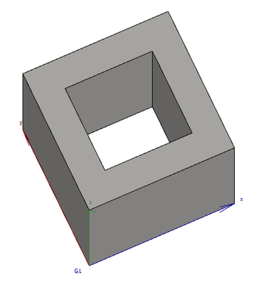

I want to make a Block in GDL with an internal hole, the object made in the simplest possible way. Of course I can make four walls and a roof and make a Block with a hole that way, but I want to make two Blocks, one regular and one smaller void-Block. Is there a command for void in GDL?

Ah, you want a hollow block with 6 sides still?
You could add slabs (prisms) to the top and bottom to plug the hole.
But easy with GROUPs.
GROUP "box"
BLOCK 1, 1, 1
ENDGROUP
GROUP "void"
ADD 0.2, 0.2, 0.2
BLOCK 0.6, 0.6, 0.6
DEL 1
ENDGROUP
result = SUBGROUP ("box","void")
PLACEGROUP result

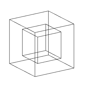

This is the wire frame view.
GROUP "box"
BLOCK 1, 1, 1
ENDGROUP
GROUP "void"
ADD 0.2, 0.2, 0.2
BLOCK 0.6, 0.6, 0.6
DEL 1
ENDGROUP
PLACEGROUP result

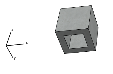

Ingolf
That worked well, and not a too complex formula. I changed it so I could see the void from the botom 🙂
Material 4
GROUP "box"
BLOCK 1, 1, 1
ENDGROUP
GROUP "void"
ADD 0.2, 0.2, 0
BLOCK 0.6, 0.6, 0.6
DEL 1
ENDGROUP
PLACEGROUP result

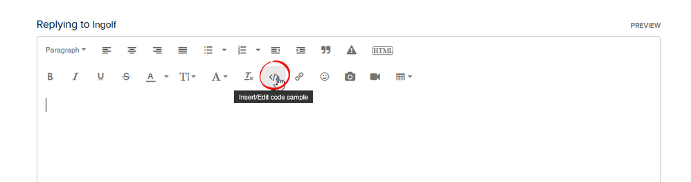

How did you do the list (with the GDL-script) in your answer? How did you place the list in a grey box with a slider? 🤔
Ingolf Sundfør, Bricklayer, Author of several Real Life Problem Solving Books for Archicaddicts in Norway.
PC/i7/W11/ArchiCAD 6.5-27
Expand the editing tool bar (3 dots) at the top where you type your reply.
That will create the code box.
