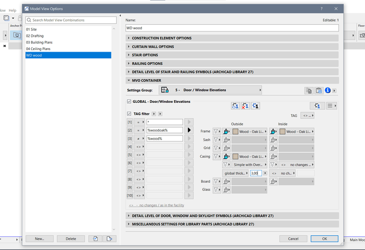

Barry Kelly, Lingwisyer, Peter Baksa thank you for your interest.
My reflection in this topic basically concerns LIBRARYGLOBAL, and to some extent refers to what Mario Sacco wrote recently:
https://community.graphisoft.com/t5/GDL/Ask-a-MVO-setting-more-parameters-with-a-single-command/m-p/...
1. Taking over individual MVO parameters
(here the parameters can have DIFFERENT types of INT/REAL/STR/BOOLEAN...), simple example:
x = LIBRARYGLOBAL (mvo_macro_gsm, "mat11", mat11)
x = LIBRARYGLOBAL (mvo_macro_gsm, "mat25", mat25)
x = LIBRARYGLOBAL (mvo_macro_gsm, "mat26", mat26)
x = LIBRARYGLOBAL (mvo_macro_gsm, "mat27", mat27)
x = LIBRARYGLOBAL (mvo_macro_gsm, "mat1010", mat1010)
2. Taking over an array from MVO
(of course the array must have a SPECIFIED content type of INT/REAL/STR/BOOLEAN...), simple example:
dim dimmat[10][10]
x = LIBRARYGLOBAL (mvo_macro_gsm, "dimmat", dimmat)
mat11=dimmat[1][1]
mat25=dimmat[2][5]
mat26=dimmat[2][6]
mat26=dimmat[2][7]
mat1010=dimmat[10][10]
I think that for a small number of parameters, method 1 is OK. For a larger number of parameters, method 2 may be better, but requires more discipline, e.g. in terms of parameter types and the structure of row and column numbers to take the appropriate parameter values from the array.
Since LIBRARYGLOBAL was released, I've been creating a lot of objects using MVOs. Unfortunately, this causes the number of tabs in the MVO to grow and they don't fit on the screen. So my long-term strategy is to use my own MVO container that combines sub-MVO settings. This causes the container to contain a lot of parameters (around 650 so there is still a supply of up to 1000...). So I'm increasingly creating some sub-MVOs using arrays instead of standalone parameters. Arrays, while somewhat limited, allow for easier scaling of data with new ideas.
Currently, MVOs are the only way to globally change some finishes on objects, because the graphic replacement rules are completely inadequate for this.
