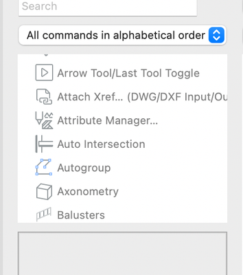

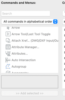

Eduardo Rolon
FYI,
The Arm version does not have the Original Attribute Manager it only has the new-UNUSABLE one. This should be in the notes.
On the other side of the coin, it is stable and "feels" snappier panning and zooming around.
Eduardo Rolón AIA NCARB
AC27 US/INT -> AC08
Macbook Pro M1 Max 64GB ram, OS X 10.XX latest
another Moderator
It's weird that the 'old' Attribute Manager interface is missing as this is supposed to be. answer version with fixes. Could it be a Work Environment issue where the Attribute Manager has been omitted from the menu?

Eduardo Rolon
Still looking for it
