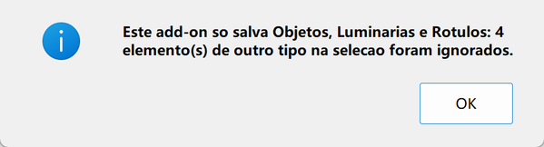

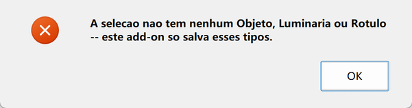

Only saves Objects and lamps (other element types in the selection are ignored).

I think there are some infos need to translate to INT version. 🙂
Allan_Fx
@Funfun Yan Fixed!
